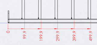

Ordinate dimensions changing after rebuild
  • Thread starter Thread starter MikeRoberts
  • Start date Start date
M
MikeRoberts
Guest
Using SolidWorks 2014
Ive got a problem using ordinate dimensions & dimensioning to the edge of round tubes.
The base line zero is off a flat edge part & I try dimensioning to the left edge of the infill tubes as shown.
(we do it this way as its quicker for the fabricators to measure to the edge rather than guessing where the centre of the tube is)
All appears ok but if I do a rebuild the dimensions flip to the incorrect side as shown
Even if I do a convert entities to the left hand side of the tube & ordinate dimension to that, after a rebuild it also flips to the wrong side
In the end I added a sketch point coincident to the left edge of the tube & took my ordinates to that.
Yesterday that worked fine even after rebuilding, but today that too is flipping to the wrong side!
Im getting frustrated & cant see where Im going wrong or what else I could try
Attachments
  • 4 Ordinate dims Converted entities on LH side of tube after rebuild.PNG
    4 Ordinate dims Converted entities on LH side of tube after rebuild.PNG
    234.8 KB · Views: 0
  • 3 Ordinate dims Converted entities on LH side of tube.PNG
    3 Ordinate dims Converted entities on LH side of tube.PNG
    215 KB · Views: 0
  • 1 Ordinate dims before rebuild.PNG
    1 Ordinate dims before rebuild.PNG
    224 KB · Views: 0
  • 2 Ordinate dims after rebuild.PNG
    2 Ordinate dims after rebuild.PNG
    198.4 KB · Views: 0
