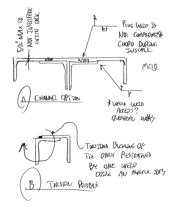

F) My preference here would be to use a channel with down turned flanges for the tie piece. That, in homage to the points that I made above:
i) torsional stability of the tie piece.
ii) meaningful, bi-directional stiffness of the tie piece to shield the joist top chord from additional bending and buckling effects.
With this, it's prudent to keep in mind that welding cost will dominate this and material costs will be immaterial. So, if it's spatially acceptable, there's little reason not to throw an MC10 in there and give yourself some stiffness and room to get things done. I was also thinking that that it might be nice to plug weld the channel to the OWSJ flanges from the top but I have a small amount of concern for temporarily melting the flanges as with transverse welding which we generally avoid in these situations.
G) I've not had great luck getting OWSJ suppliers to design their products for special conditions. They'll do it, for sure, but the price tends to shoot up in a hurry. For that reason, I try very hard not to ask for anything that would truly require any modification to the base design.
H) Keep in mind that you won't be able to keep the tie force in the top chord. A share of any imposed compression is going to shoot down to the bottom chord of the truss as soon as it encounters the first OWSJ diagonal web. What that means is that there may be an increased demand for OWSJ bottom chord bracing/bridging at the ends of the truss where the bottom chord flexural tension may not yet have overcome the imposed compression. I don't expect that additional top chord compression will cause you any grief because the top chord will normally be designed for the mid-span flexural compression demand which may well be an order of magnitude larger than anything you'll be adding with your collector design.
Just some sketches to go along with my previous post. Obviously, one needs to consider the impacts of:
1) Overhead welding.
2) Weld access.
3) The welding temporarily compromising the chord.
@OP: I actually suspect that your detail has come about from a desire to preserve a top-side welding condition. That's a big deal and may well keep you on that path.
