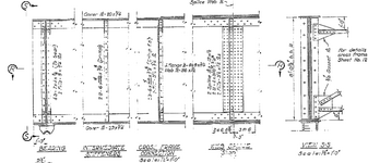

If you have pre-1960 drawings of riveted through plate bridges, it would be great if you could share sheets that have the structural steel cross sections.
Here's one, 1952 riveted plate girder. Hope the resolution works.

@Lomarandil , I appreciate your sharing the drawings. We expect our bridge girder to have similar x-section, but with more plates added to the web.
Also just noticed like lomarandils drawing, the bottom web (and also the top web? )has more plates in the middle of the span - looks like max 4 plates extra and then gradually tailing off.
