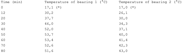

Dear all,
yesterday I finished the assembly of my equipment and tested it, and now I'm here to report some data that may be useful for others.
I'm quite impressed (positive) of the temperatures reached by the bearings.
Bearing 1 (radial deep groove single row ball bearing):
Internal diameter: 45 mm (about 1,77 inches)
External diameter: 85 mm (about 3,34 inches)
Bearing 2 (angular contact deep groove double row bearing):
Rotation speed: 2960 rpm
Static oil bath
Oil: Mobil SHC 624 (synthetic iso vg 32)
Ambient temperature: 19,4 °C
Temperatures of both bearings were recorded using 2 probes (Hanna Instruments, Checktemp); each probe was in its well, in contact with the external ring of each bearing; each well was filled with thermal paste.
(*) Temperature at time 0 < Ambient temperature: most probably due to thermal paste, colder.
I think bearing 1 reached the stationary state, bearing 2 near to the stationary state: I'm expecting at theoretical stationary state an intermediate temperature between bearing 1 and bearing 2 at 80 min.
I think even with higher ambient temperature (+20 °C more), this oil is still valid.
I think I was lucky enough this time to choose the right oil.
