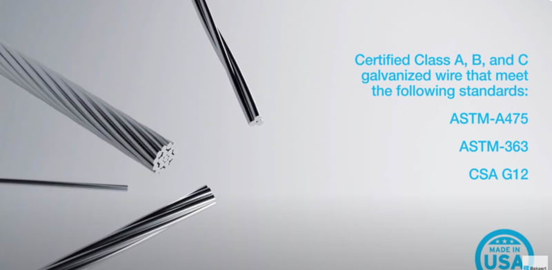

I thought the use of 5/8" steel was what is typically used?
Thank you. - use Alumoweld-Aluminum-Clad-Steel-Overhead-Ground-Wire for overhead shield wires.
