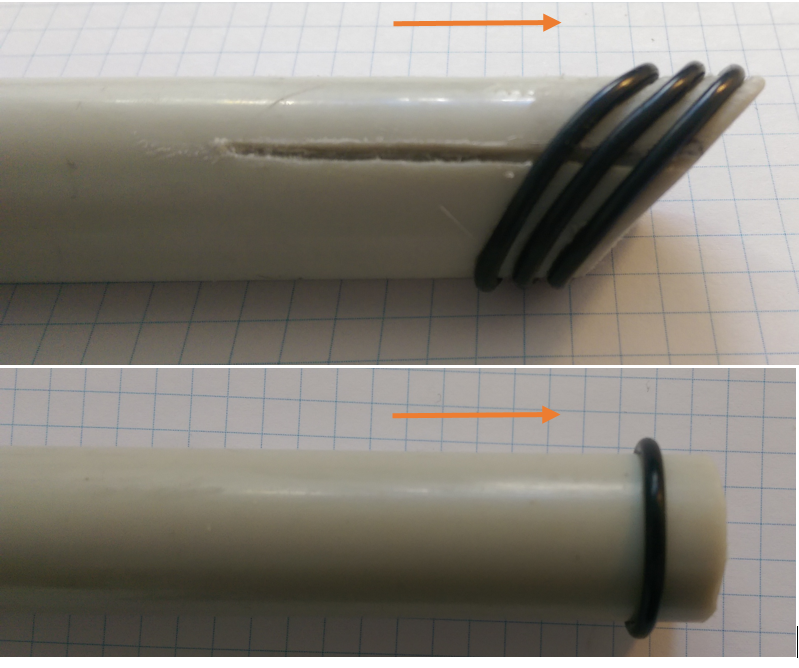

I'm working on an small project and one thing I'm in trouble with is how the 'ejection' mechanism of the o-ring can be made. (see the figure)
When the tip is at an angle the forces in the o rings are very different from that when positioned on a 'straight cut (90deg)' cylinder.
Any ideas of how that might be done? All inputs are welcome :)
Regards
Alex
For starters, applying the force to the "top" of the angle cut like you've shown with the arrow, will tighten the o-ring. Applying the force to the "bottom" will loosen up the o-ring, but it might walk over the one in front of it.
