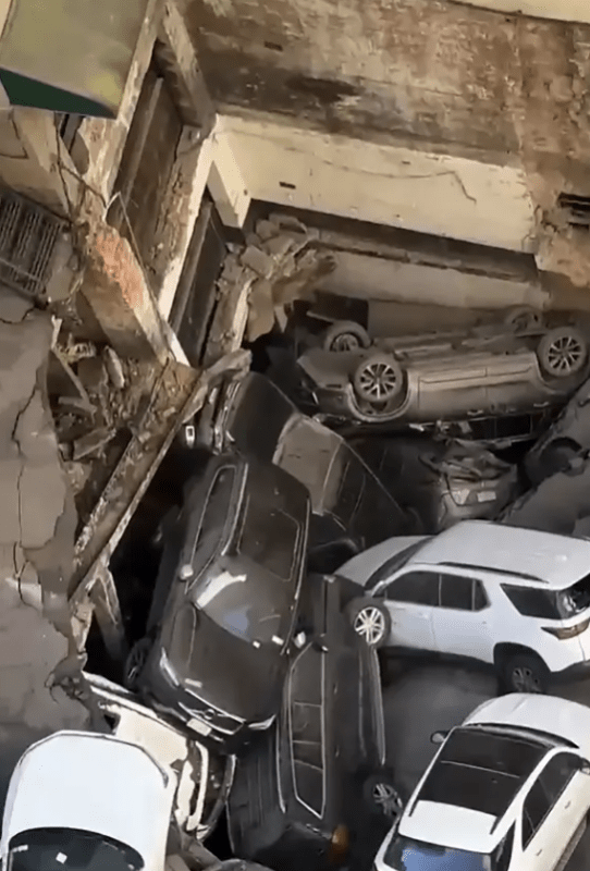

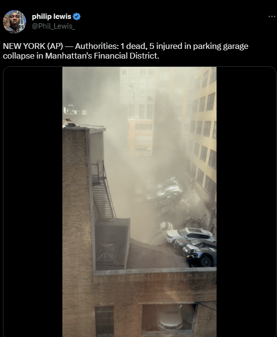

Ring camera video from inside. Not much to see though.
Looks like it was a rather old masonry and reinf concrete structure. News report stated it is over 100 years old.

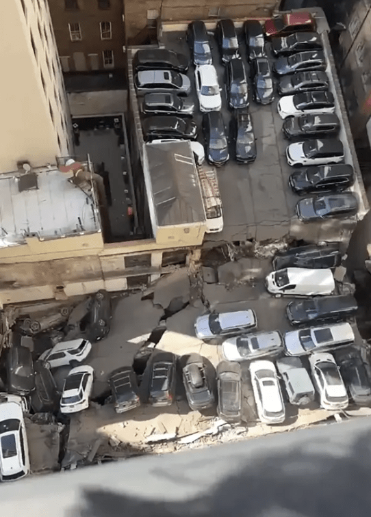

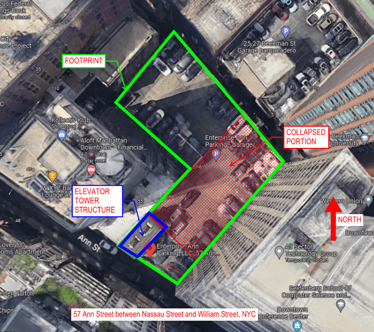

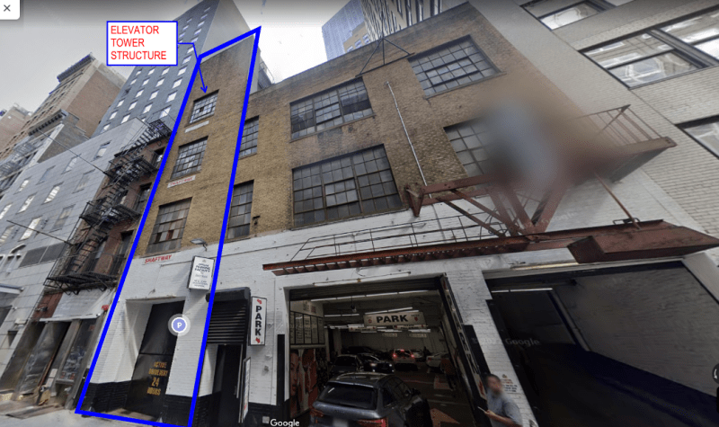

Apparently it's a full service parking garage - attendants do the parking for you. Looks like there's some sort of car elevator to take cars to the upper levels. The "roof" level looks rather packed with cars:
The situation as I have gathered:
Appears to be a pretty old structure. I'm wondering when it was built.
News report said "over 100 years old". I didn't catch the exact date but it was early 1900's. Apparently this structure had multiple "safety violations" relating to the structure itself, which were still "unresolved". News report was fairly vague on the violations but they mentioned structural deficiencies. Classic...

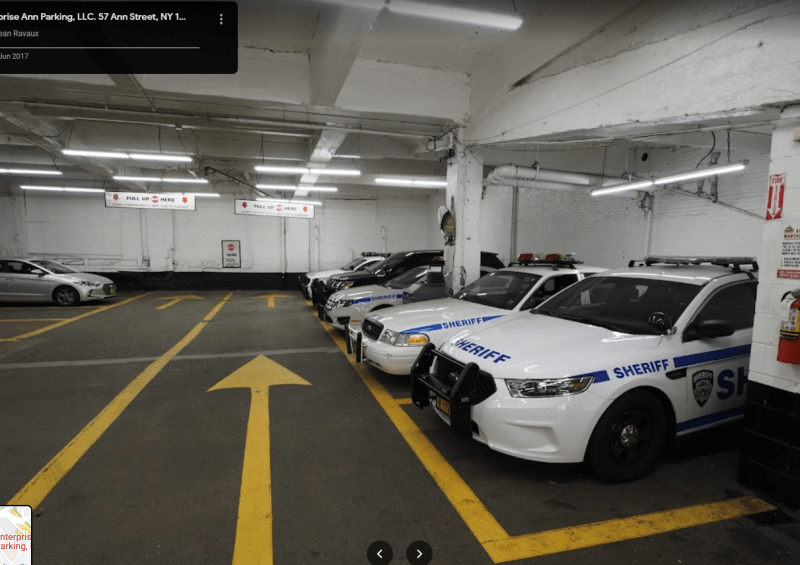

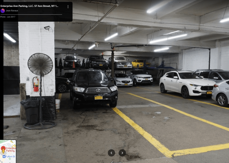

Here are some pics showing the floor structure:
Just a tad bit overloaded perhaps??

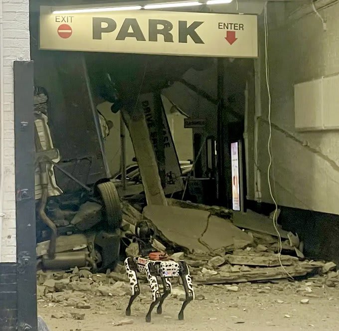

This is the first time I've seen them using Boston Dynamics dog robots in the field.
It looks a lot like verticals (walls and posts) were brick and horizontals (floors and beams) were concrete.

Like a cube van filled with helium is not the same as one filled with lead, this parkade looks over subscribed.
I had a chuckle when the news report stated "And here we have footage, courtesy of FDNY, showing their new robot dog going into the building to look for survivors". Immediately it showed the dog trying to walk onto that sloped chunk of slab and it toppled over. Granted, it did to a good job of righting itself. Funny nonetheless.
Somehow I doubt that the 40psf design live load accounts for cars shoulder-to-shoulder and packed into the aisles.

Interesting that there would be "stacked" cars as shown in one of the pictures. Might be ok in the cellar.
