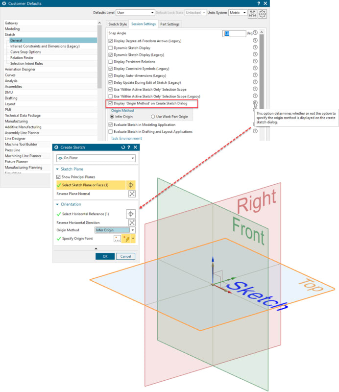

Is there a way to change the x-direction of a sketch created in NX1961 ?
I think I heard this was removed with the big sketch changes, but I really need it right now.

You need to do the following setting in customer default
I hope this help

I've noticed, that by rotating the model, when you select the face/plane, you can control the horizontal reference,

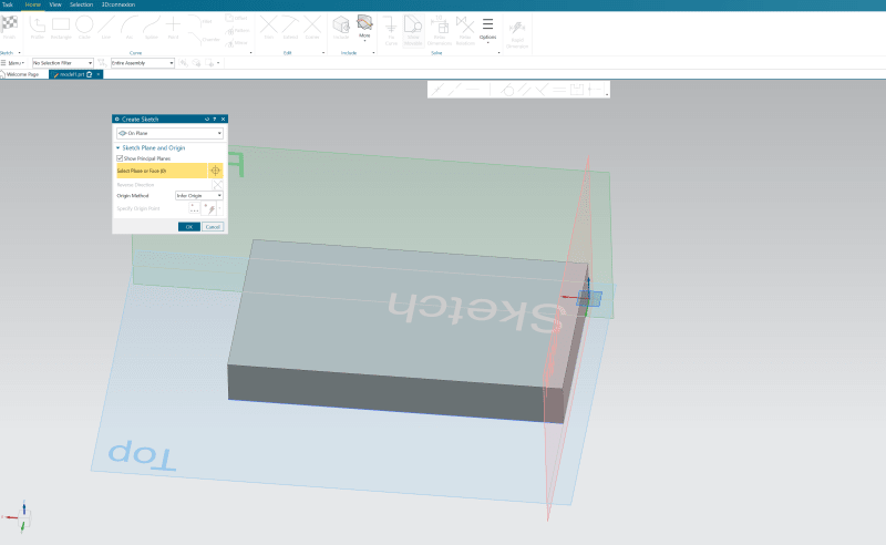

PSI-CAD,
I changed the customer default that you pointed out but I still do not see the orientation information.
Did you change anything else to get that to show.
Using NX1953
