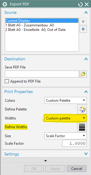

I'm always using Custom Palette for the widths. Seems to me the most straight forward way.
There you can define width for each color index in your drawing.
