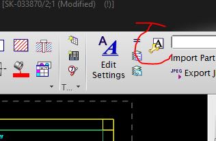

The old command is still there, at least in NX11. You can dig through the customize menus and add it to your ribbon.
It looks like Edit Annotation is there in NX1884, but editing the dimension value is not possible.
