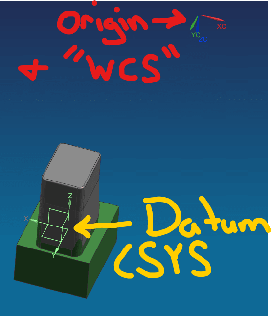

Long story short, we use NX11 primarily and have some custom functions setup. One said function writes out IGES, STEP and X_T files with just a couple clicks. One of those clicks is selecting the coordinate system we want to use. IGES and STEP export to the selected coordinate system and X_T does not.
We have a customer that has started sending us files in NX1872. Our custom functions haven't been updated to work in NX1872 so I'm having to export each file type out one at a time...but STEP does not give me the option to select a coordinate system. It only writes out to the WCS location. Short of exporting an IGES, importing said IGES, and exporting back out as a STEP, is there a way to write a STEP out to any coordinate system in a part?
Also, I can't (not that I can't, but that's not the way we do it, plus I would have to create an additional file) move the model so that the needed coordinate system and the WCS would be the same...unless that's the least complicated way.
I appreciate the help and hope I'm just overlooking something simple.

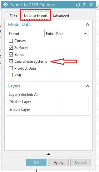

Don't move the model, move the WCS. If you have a datum coordinate system set up that you want to use, right click on it and choose "set WCS to datum csys" before you export.
www.nxjournaling.com
Cowski, that still exports to the original "origin" location and not the newly created datum CSYS.
Can you post the source code of the program that exports the STEP files on NX 11? That should tell us how it is exporting the file and we should be able to figure out a manual process from it.

Jerry, that just exports the model with the datum coordinate system in the export, it doesn't make the datum csys the 0,0,0 (origin) of the newly exported file.
To give an example of what I'm wanting to do, when I export a STEP it automatically exports with the origin as 0,0,0 (shown by the visual of the WCS). But I'm wanting to export the 3D shown with a 0,0,0 at the same place at the datum csys (marked with yellow). I can do this with IGES files (shown in the second image below).
