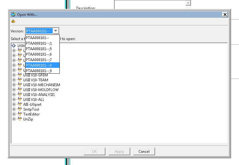

We are running NX12 with Teamcenter and I need to know how to open an earlier version of a saved Dataset. I knew how to do it in NX7, but now that procedure does not seem to work.

I find the easiest way is to locate the dataset in Teamcenter (From your design item), select it, and then use File - Open with...
In the pulldown menu you can then select which version of the dataset you want to open.

It opens correctly, but I made some changes and did a "Save" and now I need the older version back without those changes.
Thank you NutAce, did what was suggested and opened the dataset file I needed.
