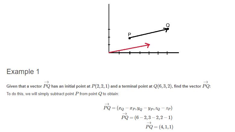

So that made sense to me...until I realized I don't know how to define a vector by 2 points...seems like it would be straightforward but I looked through my NX11 NXOpen .Net API References and User Function Reference and I couldn't figure it out...
I thought it would be the difference between two points like:
Code:
dim Xvec as Vector3 = XPt - OriginPt
But apparently I can't perform subtraction on points...
J
Subtract the co-ordinates of points. See below image.
Suresh
Thanks Suresh. I thought there was a more elegant way than explicitly working with the coordinates, but that makes sense.
Jeff
Using points you could create a direction and obtain its vector. But subtracting point co-ordinates is easier for your purpose.
Direction CreateDirection(Point startPoint, Point endPoint, SmartObject.UpdateOption updateOption)
Vector3d Direction.Vector
Suresh
The SNAP library has arithmetic for points and vectors. So, in particular, you can get a vector by subtracting one point from another. Snap requires an extra license, but there's a free subset called MiniSnap that includes all the Snap point and vector functions.
