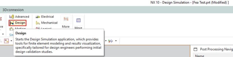

Could this be limited by the fact that this is being done under the Basic Design Simulation not the Advanced???
For this case you should use nonlinear static analysis which offers nonlinear (changing) contact interactions. This way you will be able to account for contact established during the analysis.
It seems nonlinear static analysis is not available under the Basic Design Simulation. Cab you take a look at the image and confirm that his is in fact the case.
Yes, it's definitely not there. You would have to change the solver from "NX Nastran Design" to "NX Nastran".
