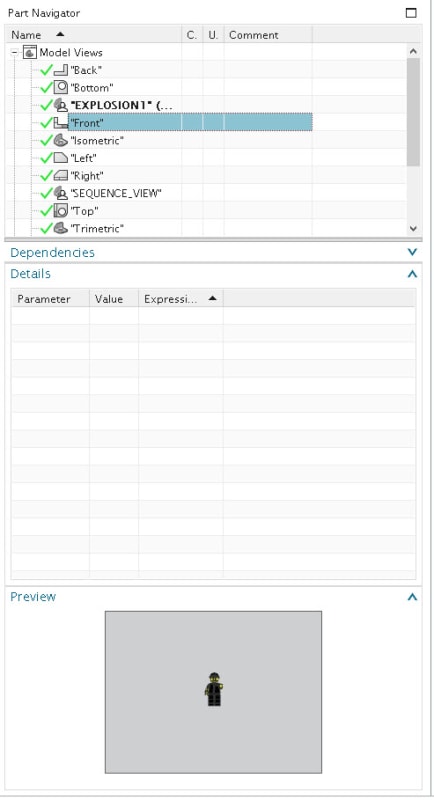

In the Part Navigator if you expand the "Model Views" node, the preview images can be seen in the Preview panel at the bottom of the navigator. These previews allow the user to evaluate the model without actually accessing the view and waiting for it to be generated.
