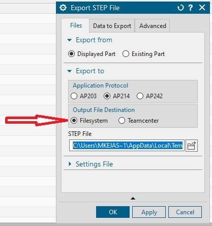

You can simply export a STEP file from a model file in TeamCenter to your filesystem.
FILE -> EXPORT -> STEP

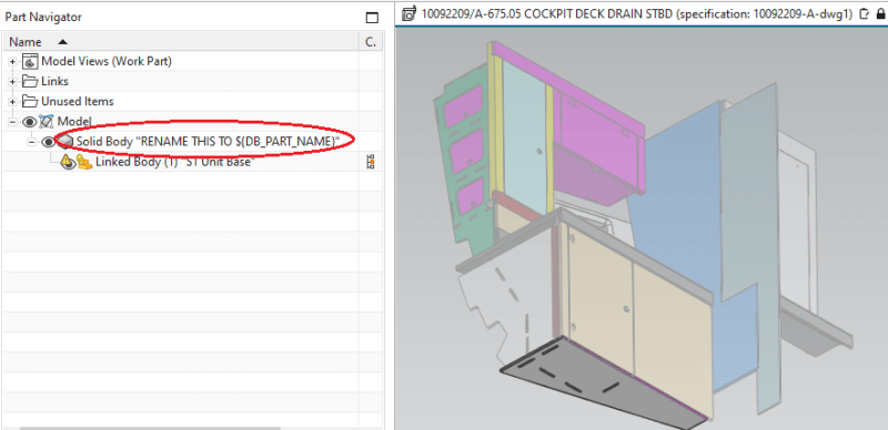

Thank you Jerry,
The problem is the renaming of the bodies in the assembly.
We could manually do this as shown in the image but I would like a way to rename the bodies for all parts in the assembly.
