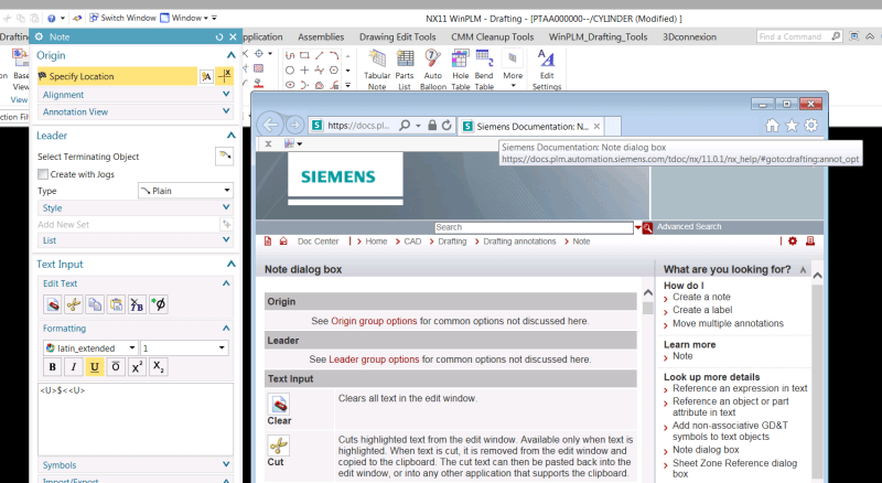

NX documentation error
aleksandar81
Jul 2, 2014
137
BA
I'm having the problem to open nx doc.Latest Java is installed,i tried with Firefox and IE but it's the same.
HTTP ERROR 500
Problem accessing /tdoc/nx/10/nx_help/. Reason:
Server Error
Caused by:
org.apache.jasper.JasperException: PWC6033: Error in Javac compilation for JSP
PWC6199: Generated servlet error:
The type java.io.ObjectInputStream cannot be resolved. It is indirectly referenced from required .class files
Just use the Online version...Much easier and always up to date..
NX 10 Docs
Ronald van den Broek
Senior Application Engineer
Winterthur Gas & Diesel Ltd
NX9 / TC10.1.2
Building new PLM environment from Scratch using NX11 / TC11
I know for online,but is there any chance to fix this.
The reason they switched to the online version was because there are always problems with the offline documentation.
Every time you update to a new javaversion, which was not in use when NX Doc was installed, you will have all kinds of issues.
Ronald van den Broek
Senior Application Engineer
Winterthur Gas & Diesel Ltd
NX9 / TC10.1.2
Building new PLM environment from Scratch using NX11 / TC11
The only problem with the on line version is the context sensitive help does not work (F1)
John Joyce
Manufacturing Engineer
Senior Aerospace CT
NX 10 & 11.0.1 Vericut 8.0.3
If I asked people what they wanted, they would have said faster horses
- Henry Ford
Joycejo said:
The only problem with the on line version is the context sensitive help does not work (F1)
That is not true. For me it is working fine :)
Ronald van den Broek
Senior Application Engineer
Winterthur Gas & Diesel Ltd
NX9 / TC10.1.2
Building new PLM environment from Scratch using NX11 / TC11
