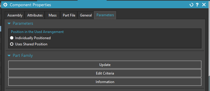

My components are all shown to be arrangement specific even though I deleted all of the constraints and there is only the default Arrangement 1. Under the position column, there is a yellow and a white circle and the tag "Unconstrained, arrangement specific".

I don't know if this directly applies to your situation, but you can make component positioning be arrangement specific even if there are no constraints involved. In the component properties -> parameters, the "individually positioned" option means the positioning is arrangement specific and "uses shared position" means the position is the same for all arrangements.
I don't have 2312 installed, but from what I've seen in other threads, the wording of the dialog seems to have changed. They may have also changed the default option, but I'm not sure about that.
