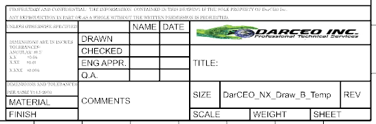

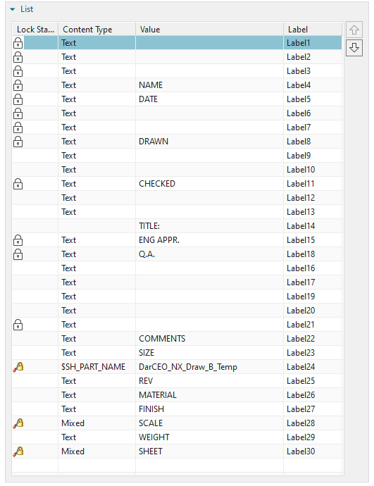

I am working on designing a library of drawing formats for the company I work for and am having issues using the Automatic Text commands from NX 12 and prior.

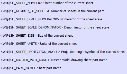

When I implement this in my Title Block, I get only the <W@SH_PART_NAME> to actually function properly. However if I use <W@SH_SHEET_SCALE_NUMERATOR> I get <WID188*0@SH_SHEET_SCALE_NUMERATOR>. I have tried been trying to find updated Automatic Text commands for the most recent version of NX (1980) and have had zero luck. In the Tables menu I have Text and Mixed for most of my Content Type. I thought that the Title would be related to <W@SH_MASTER_PART_NAME> not sure; <W@SH_SHEET_SIZE> just gives me a square block with a line through it like its some strange character not recognized.
