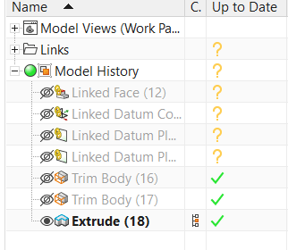

I change my load options to "load fully" and turn on interpart data (immediate levels only) and open the main assembly. I then use "make unique" on part_A to create part_B; all the links in part_B are valid at the time of creation. I'm not sure why the OP is using "delay updates"; if valid links are desired at the time of creation, it seems you do not want to delay updates. Unless I'm missing something?
www.nxjournaling.com
I've tried various load options with the NX 1899 parts and cannot get the links to break. No matter what I do, when I use "make unique" on part_A and create part_B, the links are intact in part_B. I tested on NX 1911 (which is NX 1899 with a patch, not a new major version). I'm not sure what we are doing differently...
I could install the 1915 patch and try again, but I doubt it would make a difference on my end.
In some of my experiments, the "up to date" status is unknown; but none of the links are actually broken.
