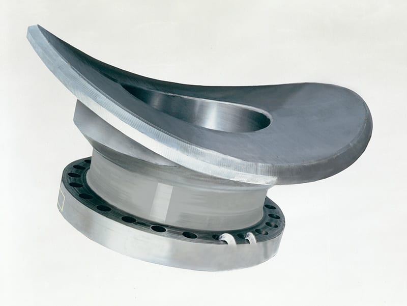

If the calculations inputs are correct you can acept it, but, if you have doubts instead of a reinforcement for your manway you can use a forged reinforced peace manway.

As a vessel designer/manufacturer we would have asked for the manhole be moved as soon as this conflict was noticed. Without knowing anything about the vessel I would still say we would have refused to leave the manhole that close to the girth weld. Either lower it to miss by 6" or more, or raise it to intersect the girth weld at a less tangential angle. A larger diameter insert plate would be another solution (looking similar to 0707's forging after installation) but being cylindrical below the girth and head shaped (spherical or elliptical) above make this almost impossible.
If your wallet is too big and needs (weight) reduction, that’s a fair option
Huub
- You never get what you expect, you only get what you inspect.
good way to say expensive XL83NL!
