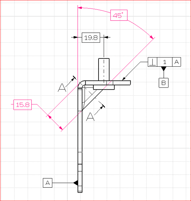

One of the views of my 2D file contain two non associative dimension (grey color).

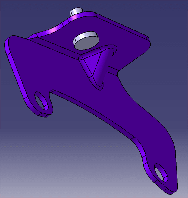

Both of them are linked to the stiffening rib:

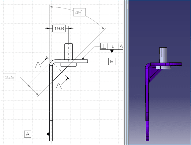

They get red when when I download the 3D file and update the drawing........
Is it possible to get/convert these two dimension on regular dimension?
Thank you...…..
CAD 2015
Both dimensions originate from tangents of the bend and the stiffening rib. cut a section and dimension there.
