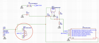

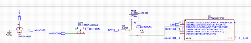

I want to replace a slide switch with a software controllable MOSFET and found this example (see drawing). I set it up on a breadboard and it works really nice with the ATtiny.
Now I want to use this for my existing circuit to basically replace the slide switch in the read circle and switch GND instead of V+ (see attachment).
my circuit is working with audio in via a mic to drive 15x WS1812 LEDs to do some sound driven animation. As soon as the MOSFET (2N7000) is inserted in line between battery and GND I am getting crazy noise on the audio signal.
I am not even adding the rest of the components of the 'low side power switch', just the 2N7000 between battery(S) and GND(D) connected to V+(G)
Any suggestion why and how to fix this?
