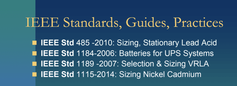

Are there significant differences in battery size calculations for NiCad vs lead acid for station service applications? I see there is an IEEE standard IEEE 1115 for calcs of NiCad batteries which I’m suspending may have similar info as IEEE 485 for lead acid type?

I did some comparison between the lead acid (IEEE 485) and NiCAD (IEEE 1115) standards and found that the process and calculations for determining required capacity is very similar. Both used same duty cycle, method of calculation (table worksheet) application of capacity factor kt for each period, and application of temp, margin and aging factors to calculated capacity.
Unless I missed something I didn't see any real difference in calculation methodology between the two. The only real difference that I saw was the difference in battery capacity factor kt with the multipliers for NiCAD being larger.
Obviously the voltages between the two are different with Lead Acid having typical minimum discharge down to 1.75V while NiCAD goes down to 1.14 typically. This appears to impact number of cells (60 for lead acid vs 92 for NiCAD) but does not appear to impact capacity calculations.
As a general question I'm curious what calculation worksheets others use and how you typically account for capacity discharge factor kt. This discharge capacity factor is based of the actual battery discharge ratings so this is somewhat of an iterative process between calculating capacity and using specific kt factor in that calculation. Is there a standard table or graph that is typically used to reference kt factor in these calculations?
