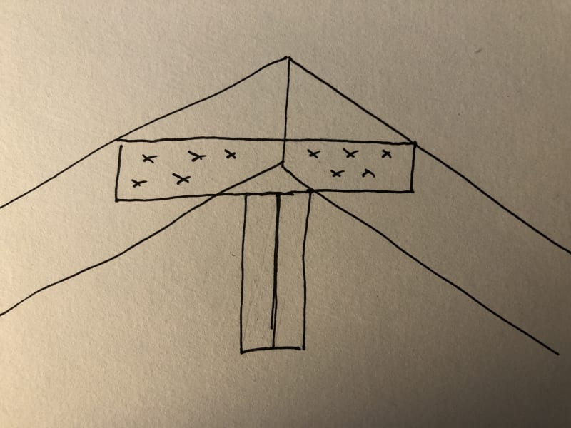

Looking to vault the roof.
I'm thinking of either notching the corners of the ridge beam or providing sloped blocking above the ridge beam for the rafters to nail.
Has anyone used these details before?
You can do either. You can bird mouth the rafters if they are 2x12. If I-Joist you do detail on the left. Don't forget the blocking between rafters. Make sure you have a load path. For example blocking toe nailed to rafters, blocking toe nailed to ridge beam. If you have a wedge above the ridge, make sure there is still load path and not terminate at the wedge.

Thanks everyone. This is for a small shed. The rafters are existing construction, without a ridge board... Notching all the rafters and make the notches align sounds difficult to me. What do you guys think?
I would go with the 2nd detail with the top of the ridge cut to match the rafter pitch. Add blocking between the rafters above the beam, as noted above. Also provide a connection between the rafters and new ridge to resist uplift.
If you’re also the builder, use a test piece to ensure you get the beam cut correct.
Birds mouth cut as others have suggested. Contractors are going to laugh at you, rightfully so, if you go with either of the two options you present.
Based on my own carpentry experience, there’s no way that cutting a birds mouth in every rafter is simpler than making two rip cuts on a table saw
Eng16080 the OP says that the rafters are existing so using the table saw to get an angle on the ridge beam members will likely result in the need to shim anyways. There is no way that the rafters of an existing shed are true along the length of the shed.
IMHO for existing construction the left detail makes more sense. Put the beams up and securely pack as required to achieve bearing. Add CFS straps if needed for uplift.
Enable, I agree there will need to be some adjustment considering that the rafters are existing. Still, I would use the approach mentioned above. Specifically, I would:

For me, this is how I would likely approach it. Cutting several birdsmouths seems like more work. The cut itself would be a pain. Cutting out the little triangle chunks would require either using an oscillating multi-tool or drilling a hole at the inside corner and removing the remainder with a jig-saw or similar all while up on a ladder. Assuming that the rafters are not true along the length (which they likely aren't), some of the birdsmouth cuts will need to be deeper than others as well for a tight fit, or shimming will be required.
I might also consider option 1 without shims if the loads are very light and crushing of the wood fibers at the sharp edge isn't a concern. Or if the loads are more moderate, I might consider the same except with a Simpson VPA connector or perhaps just an angle (L90 or similar) attached to the face of the beam along one leg and the face of the rafter along the other.
Or yet another option:
Go with option 1, with no shims, and run a horizontal piece (2x4, 2x6, or whatever) with the bottom edge set on top of the ridge beam with the face attached to the side of the existing rafters.
Now that I'm thinking it out, I think this would be my preferred approach.
A quick sketch of the alternative option mentioned above:
As shown, the ridge beam need not be tight to the bottom of the rafters (which it likely won't be if the rafters aren't true).
Per code requirement, the end of the rafter needs a minimum bearing length. Bird mouth provides a flat surface while these details provide a sloped surface. I think option one is the way to go - set up the beam first, and shim at each rafter locally to ensure bearing. Toe nails should be sufficient for the stability of gravity support, as the collar ties will not be removed. Thanks everyone.

If the rafters are existing is there a 2x ridge board? If so, why not just attach the new ridge beam to the bottom of the ridge board with Simpson LTP4s, A-34s, etc?'
Otherwise, I like the collar tie detail as presented by Eng16080 and suggested by XR250.
oh, it is just a shed? It will probably fine without anything lol. The double top plates and the perpendicular wall will take care of the thrust.
My guess is it's an old shed, hence the no ridge nailer shown, and the owner doesn't want to have any collar or rafter ties so OP is designing a ridge beam.
I'd probably show detail 1, they can take a 2x4 or 4x4 and rip it down.
This does feel like one of those details that no matter what you show the framer will do the opposite, so I wouldn't worry about it too much.
