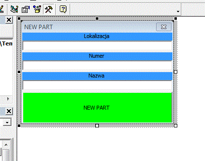

I know that application but i my company we using nameing like this part name RDB-4803-0-01-02-03-04 and in the nomeclature we typing what the part is like sheet of metal or screw. In that aplication i can only type 2 numbers for part name that's why i want to make my new macro to work difrently that that application. I was trying to make something by myself and it's looks like this
A made a table in visual basic
Lokalizacja = Location
Numer = Part Number
Nazwa = Name of the part Nomenclature
Zapis = Is the string to save the part in the location i want
and the code looks like this, is on the button NEW PART
