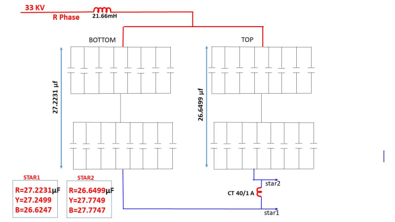

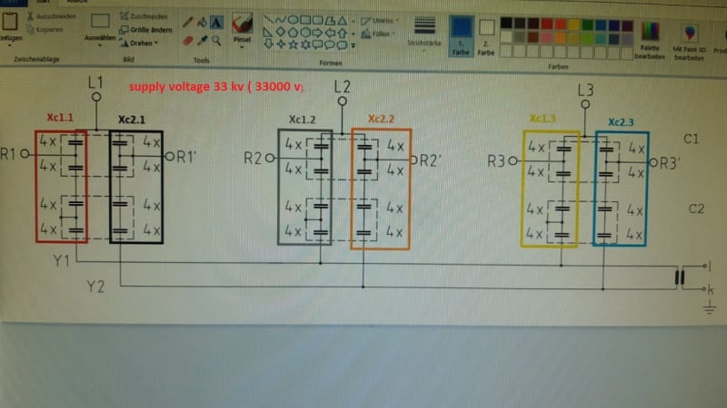

Dear Engineers,
We have Filter bank line voltage is 33 KV ( 33000V), ungrounded double star connection. capacitors are connected series parallel group. each phase one row is connected to star1 and other row is connected to star2 , unbalance CT is connected in between both star point. i want to know what is the formula for neutral current flow so can understand the % of unbalance.
i know one formula that is Iunb = ( I1+I2+I3)-(I4+I5+I6), I1,I2,I3 is one star side each phase, while I4,I5,I6 is other star side. also Iunb = Un/Xc, so i will apply the values in this formula which. I have recorded the values for Xc1 = 27.2231µF, Xc2 = 27.2499, Xc3 = 26.6247 ( one group), Xc4 = 26.6499,Xc5 = 26.7749, Xc6 = 26.7747(2nd group), hence Xc=1/2πfc, here i want to know from you guys What is Un here is it 33000 V supply voltage? or individual Capacitor name plate rating, 15000V, 459 KVAR, or someone can calculate the neutral current here, any other formula let me know.
please check the attached jpg file

Thanks Bill for reply.
i know that it will fail if anyone can fail and impedance change, actually every month we are checking all the capacitors capacitance µF value and recording. so that before starting the Equipments i should know the unbalance condition even minor also based on capacitance. sure there is formula for calculation of this Iunb current, please let me know that what equation should be for Iunb, Circuit diagram already attached, before capacitor bank also Reactor connected in series. please reply

please i want to know the how much current flowing in Neautral point if we know the capacitive reactance, so that i can know the % unbalance before starting the Filter bank. every month we are stopping the Filter Bank and recording the capacitor value. also important that before that 21.66mH inductor is connected in series with capacitor bank. Sure there is Formula but i am not getting that. please help

Addressing to your original question: you can't use neither the line voltage 33 kV directly (33/√3) nor the capacitor voltage 15 kV. If all the branches were exactly equal to each other, you could use the line voltage to obtain the currents, but in that case you wouldnt have any unbalance and there would be no point. Because you have some unbalance in the center of the stars, the voltage applied to each branch will be different from the line voltage.
Check here, on page 11, if you already have the line currents you can calculate the unbalanced current between stars.
Now, If you don't have the line currents, there is no alternative, you must do the math and solve the circuit. It seems there is no formula to calculate it right away.
I would start with something like the attachment (sorry for the awful writing). Please check for any errors, I did it in a hurry.
Good news is that you can assume that the line voltages are balanced and symmetrical, because of what Bill said.
Bad news is that you need to solve the circuit with the vectorial values of voltages and currents (you could simplify ignoring the resistances of the circuit and just deal with reactances).
Hope it helps.

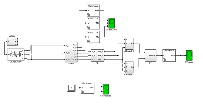

You can use Matlab Simulink for calculating unbalance current. Simulink calculate very accurately. Recently I calculated unbalance current for bank of capacitors 10 kv by Simulink, result was very similar to real unbalance.
Can you give more information about resistor, reactor, I will try to calculate unbalance.

I don't have idea about Matlab simulink, but we have LC filter the inductance is 21.66mH/phase, I am attaching the real arrangement diagram which is easy to understand but it is for one phase only, another phase also same arrangement and connecting to star point..only Capacitance value I measured which i mentioned for all phase, waiting for your reply, Supply Voltage is 33 KV

It isn't a formula, it's a model which was created in Matlab Simulink. If you have Matlab, I can send you .slx file.

afzumannu, I created this. It's is just model with your parameters.
