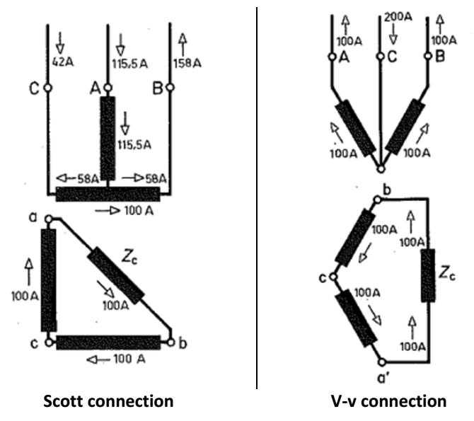

My question arose when i had a look on switchyard of railway network. The railway network in WA (Western Australia) works at 25kV AC, the railway network is given 2 phase connection at 132kV level. My question is how is the 3rd phase balanced, since the rail draws significant load when running, how is the imbalanced encountered at transmission level?
Looking forward to the replies..
Usually the main transformer has an special connection to balance the single phase load among the three phases of the transmission network.
This connection is any of the 3 phase to 1 phase variants (Scott, LeBlanc, V-v,...).
This balance is not perfect, but is much better than just a single phase load. See below some examples (Zc being the load):

Hi Argotier,
Thanks for your reply. What i grasped from your answer is that the scott Tx connection is for 3 phase primary side connection and then 2 phase on secondary, correct me if i am wrong?
With the configuration we have here is, 2 phase connection, the transformer at railway swithchyard is 2 phase 132/25kV.

BTW in the V-v connection, this does not produce true two phase.
The phase displacement is 120 degrees while true two phase has a phase displacement of 90 degrees.
One of the phase angles of the V-v primary may be reversed. 120 degrees rather than the 60 degrees shown.
This will reduce the current on "C" phase primary line.

My bad, I meant that the connections shown are 3 phase to single phase (now edited in the original reply).
These were only examples to show how the balance works with trx connections, an specific railway application may vary.
The particular railway trx connections I've seen always use in the secondary a single phase with mid-point (not quite a 2 phase system, although sometimes it's called that way wrongly), so you have two phases 180 degrees apart. For the V-v example its more like a V-v-v (the two secondaries "v" in phase opossition)
Your railway system probably is something like that, with a 25+25 kV network (this is very common).
