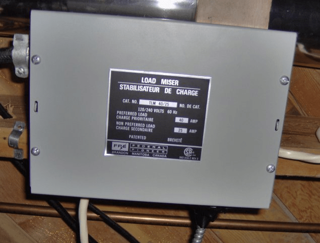

An "all in one" device was common about 50 years ago under the name "Load Miser".
They were used to give the electric range preference over electric hot water when both were installed on a 60 Amp service.
They are coming back into use to add electric vehicle charging to panels which otherwise do not have the needed spare capacity.

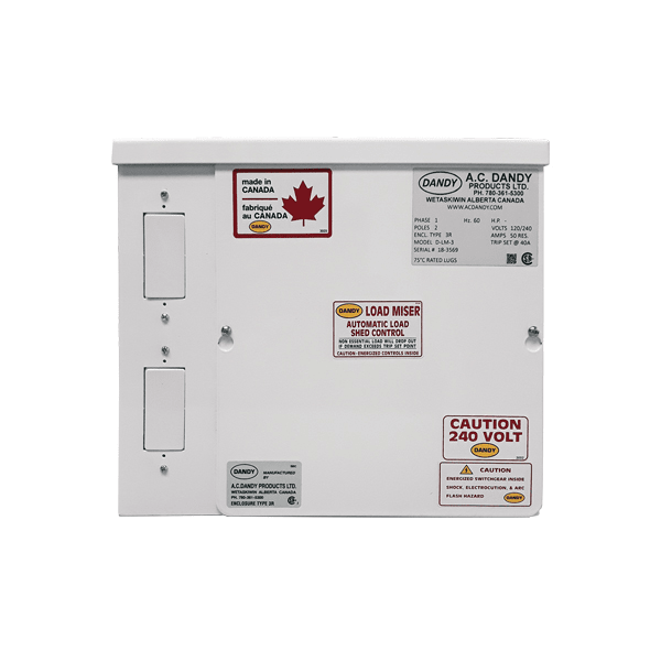

Link
DANDY LOAD MISER ENERGY DIVIDER CONTROLLER
EEMAC 3R enclosure
Specifically designed as a load saving device used where non-essential load is connected to an essential load circuit
The load saver cuts off power to the non-essential circuit only. Reducing load saves service upgrades.
Adjustable 5 to 50 amp of the circuit upstream rating
Easy to install for new and existing installations, simply connect in series of existing essential load
Ideal for energy saving or when system capacity is limited
Optional time of day clock prevents non-essential load from operation on/off hour, increasing energy savings and allowing non-essential load to operate on/off time energy availability
Sensing has adjustable 5 - 50 second time delay action to prevent rapid load cycling. Sensing is on only L1. To avoid nuisance tripping if loads are unbalanced add second phase current sensor option
CSA certified assembly
Option
Non-essential load time clock 24 hour - 15 minute increments - adjustable
