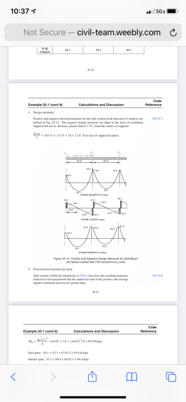

Hello all-
Can anyone explain the calculation for negative design moment in the attached example (excerpt from PCA notes ACI 318-14)? I am unable to arrive at the same numbers (32.3, 67.0, 60.8, etc) from the bottom graph.
