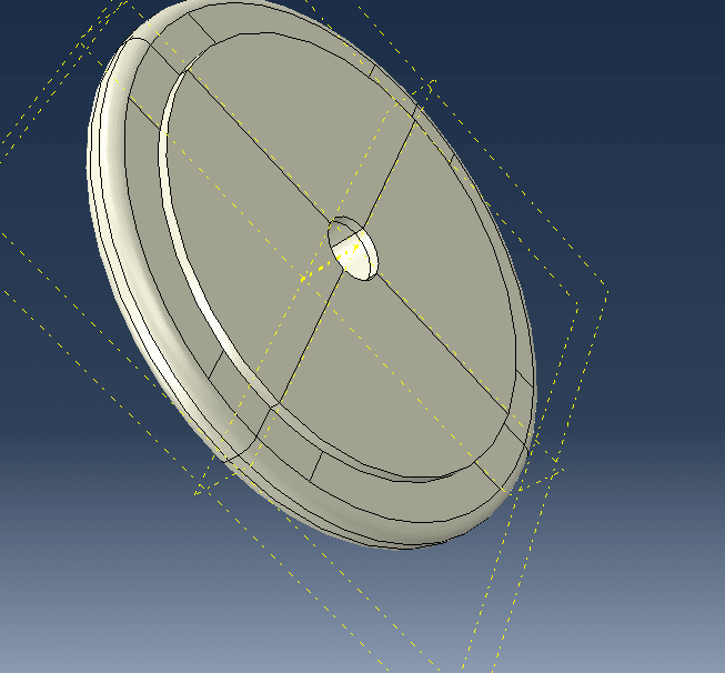

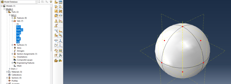

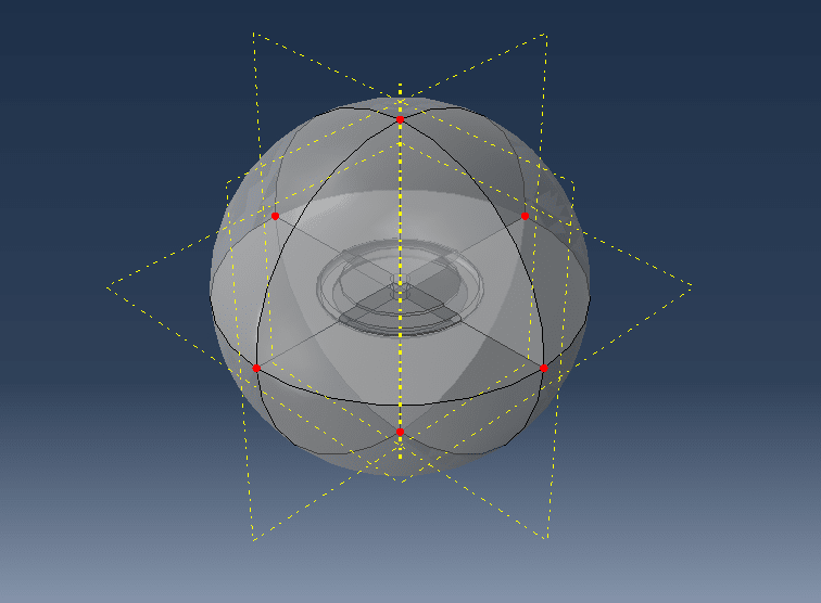

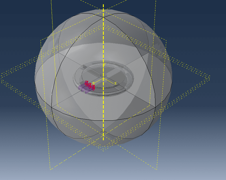

This is the assembly>
This the load applied>
This is the air domain>
This i the disc>
Well if you don't know what you are plotting then I certainly don't. A modal implies there is some excitation somewhere, so I suspect you are looking at the transfer function of pressure at a point over whatever the excitation is (probably a velocity applied somewhere on the disc). In which case negative values certainly make sense. This is a standard case for which analytical solutions exist - research radiation efficiency of a disc in free air, or piston without a baffle. Is the disc flexible? If so you will also get coincidence effects, where the speed of sound matches the speed of vibration.
Cheers
Greg Locock
