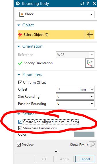

The "best fit" alignment tool in the reverse engineering looks interesting, but it is not what I was referring to.

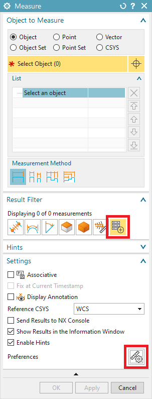

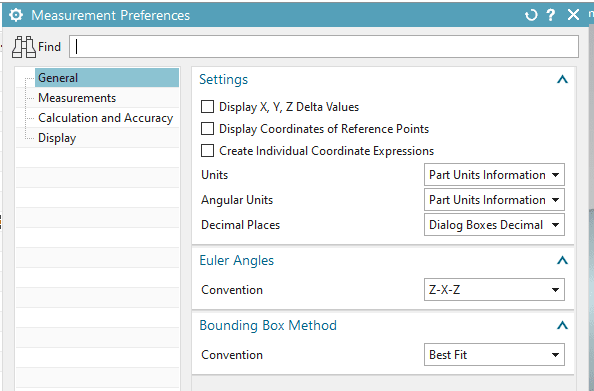

In the measure tool, there is an option for a best fit alignment bounding box. Start the measure tool, make sure the "other" measurement result is turned on, in the measure -> settings -> preferences -> general -> change the bounding box method to "best fit". In measure -> settings -> preferences -> measurements -> other, make sure the "bounding box" option is turned on. Set the selection to object and pick a solid body, a bounding box with measurements will be shown around the body.
www.nxjournaling.com
YES! this works~! You're brilliant Cowski
