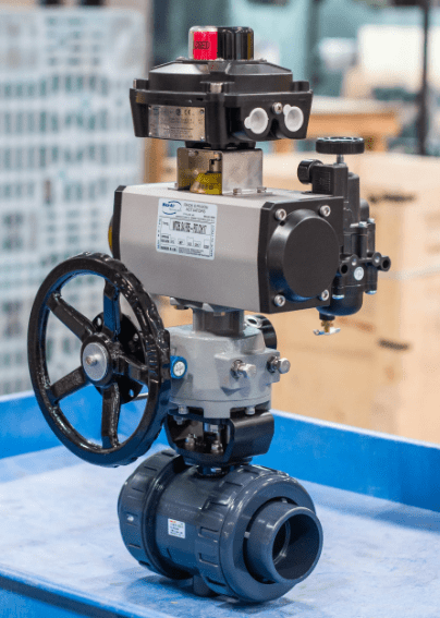

There may be individual company specifications / requirements which say this, but in reality not many valves will be able to be manually opened or closed against what is commonly a spring actuator. However there may be times when one is needed and then it becomes a matter of how the valve is opened and what permissions etc you need. It's also pretty rare to see an ESD valve with a handwheel, but not unknown. You also do get manually set valves where you open against a spring, latch it via held closed latch and in those locations you may need a handwheel.
E.g.
This is a fail closed pneumatic valve.
Depends on the service. Sometimes it can be convenient to be able to open a valve (for black start, etc.) after the nitrogen supply bottles are empty, or the emergency generator has shut down. I had to do it a couple of times using the jack lift I borrowed from my rental car. I have also had to keep a control valve positioned in the same manner. I'll be in trouble if car rental companies ever stop providing those things.
