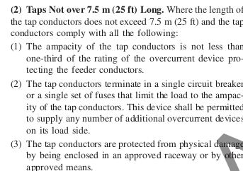

Do I need to put Breakers for 2 Separate Panel board feeders supplied from load side of Automatic transfer switch with Utility and Stand by generator sources the 2 Panel boards are within 25 Ft from Service entrance ATS (with Stand by generator source) and has their own main breakers as well. Please See attached Sketch

The breakers upstream of the ABT switch protect the 1200A cables. The 600A tap appears to meet the rules requirements.
[url=https://www.nfpa.org/Assets/files/AboutTheCodes/70/70-A2013-ROPDraft.pdf said:
PROPOSED NFPA 70® 2014 Edition National Electrical Code® 240.21B(2)]
I copies this excerpt from the "final" Draft on NFPA's website.
