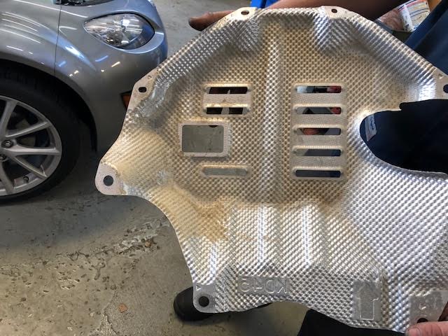

Well, thanks everyone for helping out. Here is another picture which makes me think it was sitting in water somewhere:
I didn't include it before, because I don't know exactly where it goes under the vehicle. Judging from the line around it, That looks like the level of the water line that it was sitting in. I wish I could go look at it, but I am having my own vehicle problems right now, so I can't drive up to get a look at it. I would think there would be other location where you could see a water line.
The other thing that seems odd to me is that todays exhaust systems are usually pretty durable, but the pipe, muffler, and the cylinder I labeled as catalyst are all quite rusted. It looks like whatever coating was on it is starting to flake off, which is something I haven't seen before.

Why is this so hard to believe? Even if the car was dry in a garage during the hurricane, the observed damage still is consistent the car being subsequently driven through a partially flooded area before the waters receded. Locations of corrosion are sure consistent with this, and as has been suggested brake problems are also consistent with such corrosion. This explanation falls under Occam's Razor, a rule I deeply believe in and apply.
As for explanations involving shipment or manufacture, the other cars in the same lot would be exhibiting damage from subsequent exposure. You have not found any evidence of that. And routine exposure in a coastal area also does not make sense - all other Mazdas would also be again experiencing this problem. In truth, modern automobiles are made to resist normal environmental corrosion - that is why manufacturers have long corrosion warranties on new vehicles (I think they are for 8 years, but I may be wrong). This vehicle instead saw unusual service conditions.
