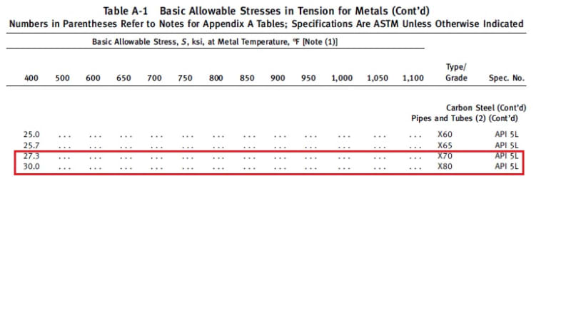

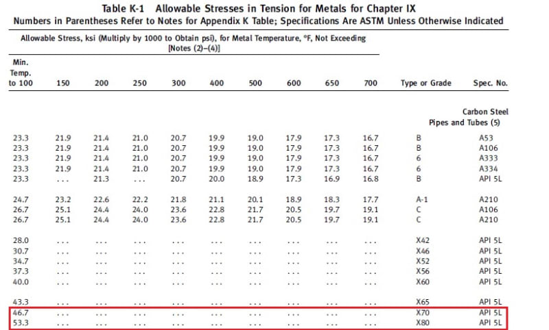

I had selected the X70 and the X80, but to use them there is a temperature limit, as you can see:

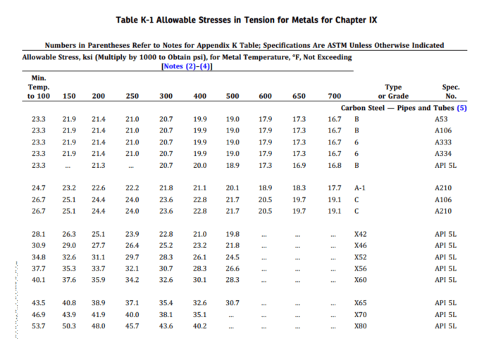

I tried to use the table A-1 , but the allowable stress are much less.
Using the information in table A-1, the following are the required thicknesses for specifics OD:
API 5L X70
- OD 101,6mm -> thick 26mm;
- OD 168,3mm -> thick 42 mm;
- OD 273,1mm -> thick 68 mm.
API 5L X80
- OD 101,6mm -> thick 20mm;
- OD 168,3mm -> thick 33 mm;
- OD 273,1mm -> thick 51 mm.
