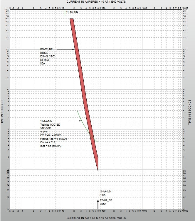

Recently in my plant, there was transformer's fault that protected by Fuses. The fuses didn't trip, later the upstream protection (circuit breaker) cleared the fault.
I want to make sure fuse tripping time at fault current (from relay event record).

The fuses are BUSSMAN HRC fuse, 17.5SFMSJ80A, protecting 500 kVA 13.8/2.4 kV transformer. The fuses were oversized, but it should have trip before upstream protection.
Load current prior fault were very low and stay low almost all the time. The load was only 1 ESP motor, approximately 1 amps @13.8 kV. The fault current detected by upstream relay were: 272/1154/242/677 (ia/ib/ic/in)

Was there neutral overcurrent protection upstream? This could have tripped with 677 A neutral current before the fuses blew on phase current.
RRagunath, I think the load never went between 80A and 270A. But the fuse probably used for another transformer before.
jghrist, yes, upstream protection (50N) cleared the fault.
Sounds like the system worked as designed. Fuses can only respond to phase current, not residual; and attempting coordination with a 50 element will always leave gaps. Good coordination software might be helpful in analyzing this.
Stevenal, i've checked using Easy Power. Below the coordination for SLG fault at TR's HV.
The simulated fault current quite similar with the actual one.
