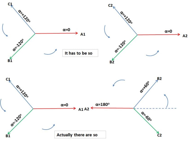

This order is good only if all the cable phase are the same as really parallel cables.
The 2 central feeders are not the same since the currents run in opposite directions.
Then an unbalance between parallel conductors of the same phase could be present.
I don't know if that situation could influence the shield and armor currents but it could be.
My program is for parallel cables only.
