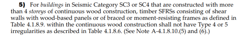

Of course, the code reference is provided in the attached image and found in NBCC 2020 Part 4 4.1.8.10 5).
To further explain my question, I am looking for an explanation on why exterior walls of a multi-storey woodframe are sheathed when typically the lateral resisting shearwalls are located internally (corridor/demising walls) to avoid openings and vertical discontinuities. However, if the exterior walls are sheathed and edge nailed, does that impact the overall stiffness per floor and violate the code reference? Or is exterior wall sheathing lightly nailed and such to provide support for building envelope. I find it hard to believe a multi-storey structure without exterior sheathing..
An example of this would be lets say a 5-storey woodframe building, storeys 2-5 have all similar openings on the exterior walls but storey 1 openings are in different locations and cause vertical discontinuity with the exterior shearwalls above, rendering them unuseable. In this case without changing opening locations, are the exterior walls just simple load bearing walls with no sheathing? Or some reduced stiffness so it does not violate the code reference for the overall lateral resisting system.

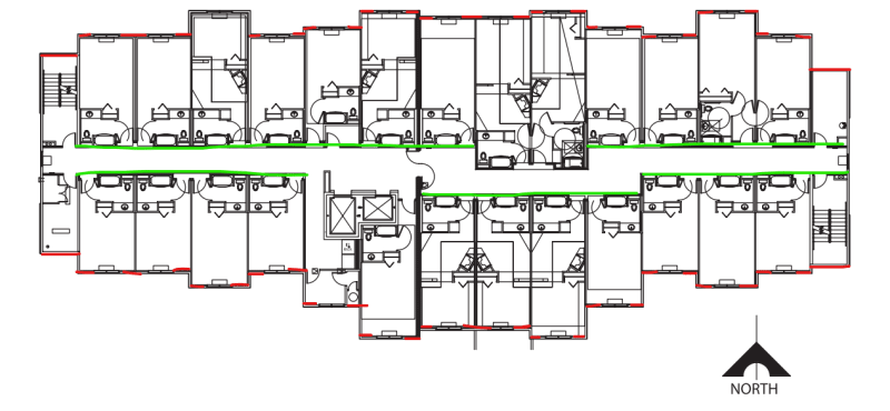

Bump, and a further explanation to help visualize:
Below is a typical floorplan of a multi-storey woodframe building. As an example, I've marked up shearwalls in the corridor as green to resist the E-W lateral forces. Where my question lies is that if I've chosen the green walls as shearwalls (because they are continuous vertically from foundation to roof without offsets), what would be the typical sheathing for the exterior walls to not play a factor with the overall system because they are discontinuous (due to offsets and openings at each level) and violate the code reference mentioned above. Are the red exterior walls sheathed anyways? Is there a situation where they arent?
I'm also not familiar with the code you reference, but I would consider sheathing the exterior walls as you normally would, presumably with "wood-based panels," but would not design those walls as shear walls. The walls would still resist gravity loads and out-of-plane loads but would not be detailed to resist in plane lateral forces. Therefore they would not meet the definition of "shear walls" and should therefore be in conformance with the code reference you posted above. I would not consider a wood framed wall with "wood-based panel" sheathing as automatically meeting the definition of shear wall.
Again, I'm not familiar with your code. This is simply my 10 minute interpretation.
