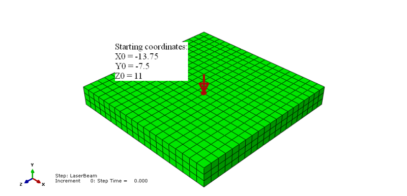

I have to write the DFLUX subroutine for moving heat flux (laser, described by Gaussian equation). It should be "volumetric heat flux". I am novice in writing subroutines. It is first in my life.
Here is the equation:
And here is the figure of substrate, on which the heat flux is applied:
Starting coordinates of the beam are (mm are used in whole model):
X0 = -13.75 [mm]
Y0 = -7.5 [mm]
Z0 = 11 [mm]
Characteristics of laser:
Scanning speeds: 4-6mm/s
Laser power: 120W
Laser spot size: 1-1.2mm at diameter
Focus distance: 5mm
DFLUX subroutine:
Because of the fact, that I do not have experience in writing subroutines, I want to start from the easiest case. First, I want to define heat flux without moving (stationary):

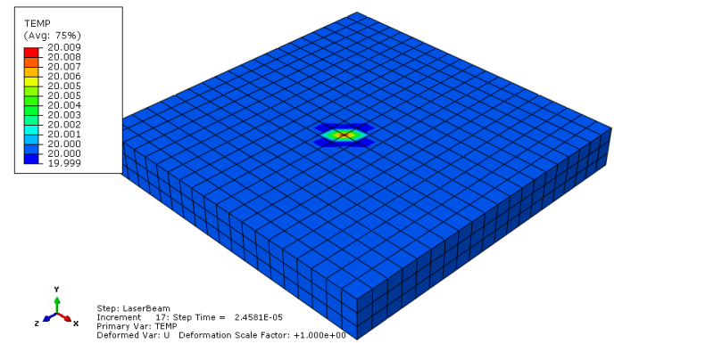

The upgraded code is presented below:
Code:
      SUBROUTINE DFLUX(FLUX,SOL,KSTEP,KINC,TIME,NOEL,NPT,COORDS,
     1 JLTYP,TEMP,PRESS,SNAME)
C
      INCLUDE 'ABA_PARAM.INC'
C
      DIMENSION FLUX(2), TIME(2), COORDS(3)
      CHARACTER*80 SNAME
      QL=120000.d0                        !LASER POWER [mW]
      R0=0.6d0                            !BEAM RADIUS [mm]
      DEPTH=0.5d0                         !PENETRATION DEPTH [mm]
      Q=(QL/(R0**2*3.1415926d0*DEPTH))    !BODY FLUX [mW/mm^3] ?
!     V=5.d0                              !LASER BEAM VELOCITY [mm/s]
      X0=-13.75d0                         !STARTING COORDINATE OF THE LASER BEAM
      Y0=-7.5d0                           !STARTING COORDINATE OF THE LASER BEAM
      Z0=11.d0                            !STARTING COORDINATE OF THE LASER BEAM
      X=COORDS(1)
      Y=COORDS(2)
      Z=COORDS(3)
      IF(X.EQ.X0) THEN
      FLUX(1)=Q
      ELSE
      FLUX(1)=0
      END IF
      RETURN
      END
The results are:

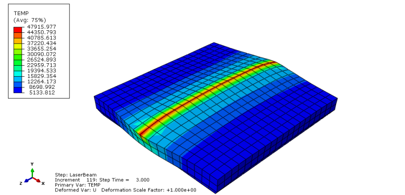

It looks good, but I don't understand why the temperature values are so big.

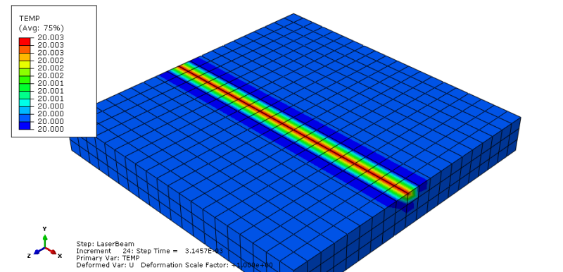

When I try to do the same, but with Z coordinates:
Code:
C
C
      CHARACTER*80 SNAME
      X=COORDS(1)
      Y=COORDS(2)
      Z=COORDS(3)
      [COLOR=#CC0000]IF(Z.EQ.Z0) THEN[/color]
      FLUX(1)=Q
      ELSE
      FLUX(1)=0
      END IF
      RETURN
      END
I get:

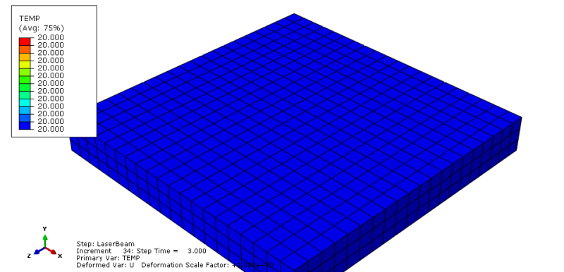

The temperature values are very small. Additionaly, above results refer to very small step time value. At the end of the simulation, there is no heat flux effect:

Are you aware that you just get energy entered, when an integration point of an element surface is exactly at your X0 and Z0 coordinates?
Yes, but this energy enters right at the beginning of the step. Next, it disappears. Why it disappears?
Maybe the integration point moves a little bit because of thermal expansion. But only if you do a fully-coupled analysis.
You were right Mustaine3. I removed the thermal expansion coefficient and it works very good now.

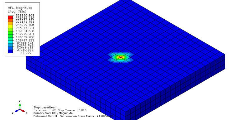

But this code doesn't work. How can I make it work?
And why the values of heat flux density are so huge?:
I refresh the topic again.
How can I expand the heat flux affected area?
Check your IF formula again. I think it will never be fulfilled with your data.
You are right, but I know, that IF formula is a problem.
I do not have an idea how to modify it to obtain desired expanded heat flux affected area.
I did few mistakes in that subroutine.
