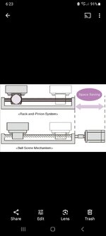

I have a geared motor bolted onto a moving plate supported by rollers standing on a fixed base. The same fixed base has a rack on the bottom. There are 4 rollers, 2 on each side of the fixed base, and they're on separate shafts (there's material between the two sides, and it cannot have holes). The moving plate assembly can get up to a mass of 1,000 kg.
Sizes and materials here are quite large (plate is 600mm wide, made of 12mm laser-cut steel, and the fixed base is a standard beam profile) so no tolerances can be reliably specified to get the correct mesh engagement. This has been built and tested, it failed because the gear teeth didn't fully engage, then solved with a not-so-repeatable nor time-efficient method for a long-term product line. (Having to shim the rack to push it into the pinion is not a solution, at least for our requirements)
I've tried to find some existing designs where gears are designed with adjustable centers, but my research has led me nowhere. One idea I've had is to mount the rollers on shafts with offset centers (one of which is threaded and tightened to the plate by a nut), but that adds complexity to the assembly pretty quickly, since the four rollers have to be adjusted independently.
Any help is appreciated, thanks.
Many gear trains have an idler gear on an adjustable/offset pivot, similar to an automotive belt tensioner or multispeed bicycle chain tensioner. Instead of applying constant spring tension, techs manually rotate the pivot to set mesh depth and tighten a few bolts to lock the mechanism. Typically the center pivot has a flange with slotted holes for the locking bolts. A bit of care needs to be taken in design and stackup analysis to ensure reasonably equal mesh between the idler and gears upstream and downstream, bc obviously the pivot/idler swings in an arc but its not particularly challenging.

As for the mechanism, I believe a powered screw would run into the same issue, where the nut needs to be precisely located relative to the rollers. I wouldn't prefer a screw mechanism anyway since my travel is 6m and I don't have space for a fixed motor.

A lead screw would require bearings on each end and could be adjusted to keep the assembly level and prevent jamming. May be a better option.
Since the nut could be brass.

I want to be able to set the engagement during assembly, that's why I'm looking for an adjustable design. The current design fixes the center and I have no control over it. The problem is high tolerance stack-up, and the option of specifying lower tolerances is not available.

The issue is I have a fixed pinion center-distance in a low-precision manufacturing process and since I don't have the option to tighten tolerances, I'm trying to make an adjustable center-distance that can manually changed during assembly.

I have worked with a helically geared assembly in which the pinion is mounted in an eccentrically-piloted cartridge. This allowed multiple pinion options to mate with a single gear. The original design had pre-machined dowel pin holes for each ratio (each ratio with its own center distance) but the design failed to perform a tolerance study that would have shown the stackup plus our machining accuracies would not hold the desired tolerance for assembled backlash.
Anyway the point is we succeeded by having the assembler manually rotate the cartridge in its pilot until the correct backlash was present, then we finish torqued the bolts and match-drilled the dowel pin. Maybe that could work for you.
