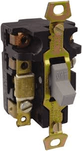

Here is a single phase manual starter with a melting alloy heater installed.
Here is a three phase, manual starter.
