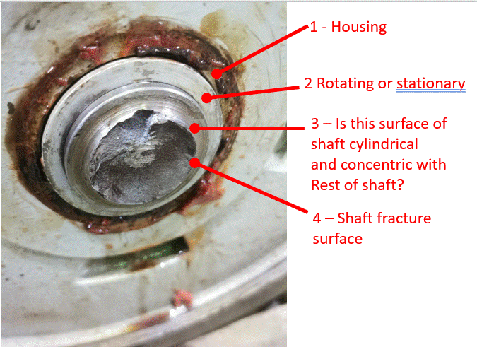

Recently we had a failure on a motor shaft (attached)
the motor is vertical and connected to lube oil centrifugal pump via grid coupling
After the failure, we confirmed both motor shaft and pump shaft are rotating freely
The only finding was pump shaft runout to be 7 mils. We measured that runout with pump assembled (not on V block)
New pumps will have 2 mils or less when we measure the shaft runout with pump assembled.
Any idea if that amount of runout will cause such failure ?

I can't figure out exactly what I'm looking at in the 1st photo.
What is piece 2? For starters, is piece 2 rotating or stationary? It's painted as if it's stationary. But the larger gap around the outside of it with grease coming out looks like the clearance between rotating shaft and stationary parts which would suggest piece 2 is rotating. If piece 2 is an inner ring, then it's so far out of the stationary hole that I'd think the cage/rolling elements would be contacting the stationary housing. If piece 2 is a part of the shaft then it's partially painted with a clean line between painted/unpainted and there would be two shaft steps very close together (I'm not saying that's a problem, just trying to figure out what I'm looking at).
Also looking at arrow 3 pointing to a portion of the shaft... is that portion cyclindrical and concentric with the rest of the shaft? It looks tilted to me (maybe that's just the angle).
(2B)+(2B)' ?
electricpete
Piece 2 is rotating and functions like slingers
Point 3 being concetric or not, I will take a look at it again maybe tomorrow, since these are the only photos I have currently.
ok thanks, now piece 2 makes more sense.
As far as whether that surface 3 is cylindrical/concentric, from that view it almost looks like you have a conical section of shaft which blends smoothly into the radius of the shaft step, but surely that's just a trick of the camera angle.
I don't really recognize any "classical" obvious failure mode in the shaft fractures, like for example shown here. Often for fatigue failure you can see obvious beach marks in photos like yours, but sometimes it needs closer inspection or maybe just more expert eyes than mine.
(2B)+(2B)' ?
