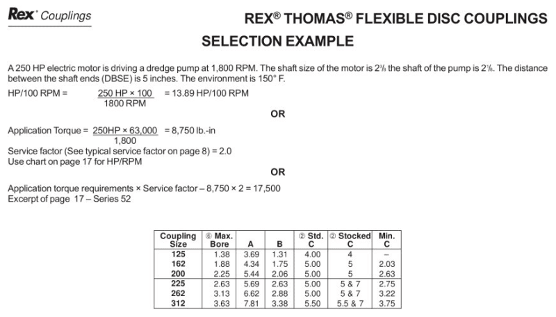

Coupling manufacturers recommend a rather cruder approach to sizing using service factors
see page 8 of this reference for an example [URL unfurl="true" said:
https://pdf.directindustry.com/pdf/rexnord-industries-llc/thomas-coupling-catalog/7386-330607-_2.html[/URL]]
