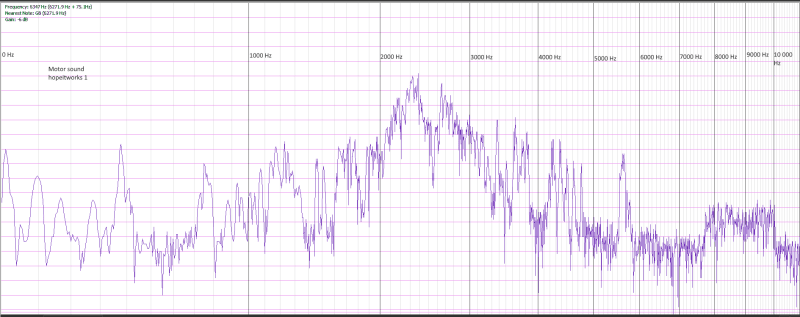

FWIW / a spectrum of the sound>
Stable frequensis. Stepper motor perhaps.
