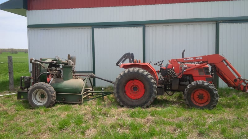

I want to build a manure application bar with an integrated compressor for cleaning out the drag hoses by pushing a foam plug from the field back to the storage pit. What's a simple, compact and inexpensive way to generate 300 cfm at 50 psi powered by a 1000 rpm tractor pto shaft?
One thought was a vane compressor but the ones used on sewage tankers and such are often only rated to 20 psi output. Higher pressure ones often require external lubrication and cooling systems which is no longer simple or compact.
Another thought was an old engine with custom built heads but I'm struggling to find a good source for suction and exhaust valves.
Thanks in advance for your ideas!

300 cfm in.
Screw compressors are definitely the most common for that kind of capacity, but they require oil separators and coolers which is no longer simple or compact. The compressor that we currently use is a large sullair screw compressor that I converted to pto drive. It was formerly powered by a 150 hp electric motor. I am running it about half speed as that's all the tractor can handle.
300 cfm for how long?
Big reservoir and a small compressor?
The tractor we use on the applicator bar is about 95 pto hp.
We also use this compressor for cleaning off equipment so it can run for an hour or more. A tank won't cut it.

Yes, we call it a pig, but I figured "foam plug" would make more sense to most people!
The hoses have to be flat and therefore empty to roll them up, pushing the pig with water is pointless.
Too little air is hopeless as it takes forever to clean out the hoses and the pig will often get stuck at a kink if the air can get by it. As the pig nears the end, the pressure drops as there is less and less liquid to push out. The launcher is 20' away from the tractor and pointed the opposite way, hundreds of feet of open field all around. All three of those videos had an unrestrained hose which is not the case for us. Also, the worker who unfortunately was killed, was not killed by the hose.
Anyway, back to the original question: I need a simple compact compressor for 300 cfm and 50 psi.
