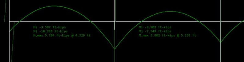

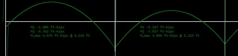

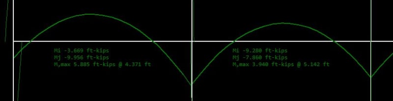

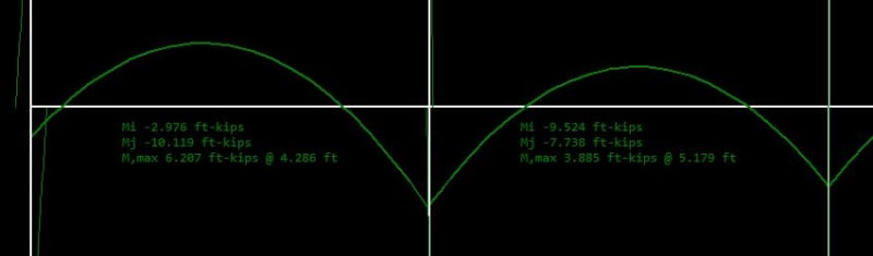

Understand the total of WL2/8 as a whole will not change. I guess what I tried to say what I initiated this was, say use your example, I have different reinforcement for span and ends and if I design to the elastic case with ql^2/24 for my design positive moment, and when it cracks over the ends, the positive bending moment will increase to upto WL^2/8 (when they become hinge at ends though it wont happen as we design the end to WL^2/12 in the first place) then it might be under designed for the span. But I just realized that when the redistributed positive moment increase to Mcr value it will be redistributed to elsewhere again and when designing we design to plastic section as centondollar pointed out so the capacity it will be way greater than Mcr... Overthinking here
Info for the following plots:
Spans- 10ft (4 total so model is symmetric)
Column heights - 10 ft
Column far end fixity - Fixed
Columns assumed not to be compressible
f'c = 4 ksi
Beams - 12x24 with (3)#8 top and bottom
Cols - 12x12 with 1% As
Beams loaded with a UDL of 1 kip/ft
Gross Moment of Inertia for all members:
Beams with 0.35 Ig:
Exterior Beams with 0.35 Ig everything else Ig:
Interior Beams with 0.35 Ig everything else Ig:
Beams 0.35 Ig and Cols 0.7 Ig:
