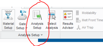

We are trying to run PTC Creo Mold Analysis (CMA) but it is locking up mold analysis set-up.
Are other users able to get this to work ?
