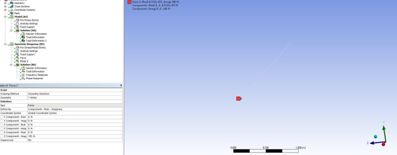

I have very little to no experience with rotor dynamics, so this relates only on how to add a rotating force. Below is just one possible way to add an unbalanced/rotating force in harmonic response FEA (e.g., F= Mass_unbalanced*radius*omega^2).
It can for instance be achieved by having two forces with directions perpendicular to each other, and with a phase shift of 90 degrees. That means in ansys wb, that one force has a pure real part (see below, 100 N real part in Y), and the other one has a pure imaginary part (see below, 100 N imaginary part in Z).
These forces can be applied to a single individual node (not part of the shaft mesh) in the centre of the shaft that also has a mass21 on it. It is linked and connects to the mesh of the cross section via links (see RBE3 in ansys apdl). Thus it is a point for remote load applications, and the force is distributed on the the mesh via the RBE3.

This is just my idea (taken from my Strand7 experience - Strand7 does not have any rotor-dynamic capabilities). There must be a lot of material on the Internet about this so it is good to have a search (e.g., Example: Harmonic Response to Unbalanced Force using Component Mode Synthesis (CMS)). There is also a rotating force in workbench (harmonic), see if that helps also. At least in workbench this is doing a similar/same thing as described in the first and second paragraph here at the top.
