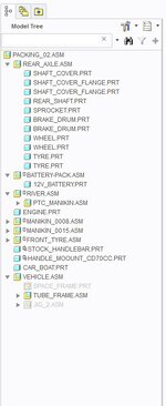

I'm having the same problem as Sodam stated. I have checked all the parts. No part is saved at a far location from model.
Attaching the snap shot of the model.
